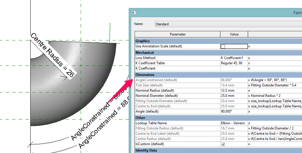

I opened an elbow family as example. You see that there are several angle parameters.
Those have to be constrained with some addtional parameter and formulas.
For example
It is of course also possible just to make two (fixed) elbows. One of 69 degrees and another of 88 degrees and attach one or the other depending on your needs.

Look closely at the second image of my earlier post. You will see that I have replaced some of the parameters in the model and that I added a formula in the parameters window.
Hereby an example of a modified elbow. It needs some checking to se if it works well.

The Problem is: Even through making a new Family with constrained Angles, the Pipes will still connect with a near 90° Angle to the 88° Fitting.. it doesnt work. It Looks like the Fitting only Visually changes, but the angle remains..
In the MEP-Settings i set the Option to Free-Angles and tried to draw a 90° Elbow with my 88° Elbow-Family., the Elbow now goes to 89,7°..... See the attaced Picture.
