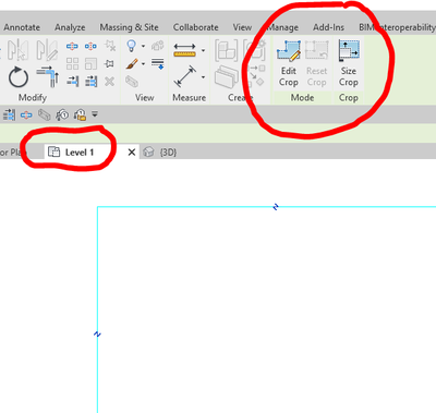

Is there a viable way to insert a crop view with irregular node points for making piping isometrics from a large piping 3D model. There appears to be irregular shapes for plan drawing crop views, but not on an isometric/3D view.

I think it would be possible to get what you want with multiple views on a sheet. I don't think you can make a 3D crop similar to a model in place type of thing.

No, it doesn't give that option for 3D views

As mentioned in the previous comments, this is impossible. I recommend if you can clarify more about your need so we can provide alternative solutions.

Our team creates a DWG from a DXF export of a piping system from AutoPIPE and XREF it AutoCAD. The Viewports in AutoCAD are of course editable into a polygon. I was hoping this feature would be possible in Revit.
