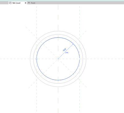

I am in the extrusion, I want the diameter, not the radius...

Hi @pe_simon, when modifying an extrusion, the radial dimension is the default assigned while the sketch is being created or selected. However, you can create a "Diameter" type dimension and associate it to your extrusion sketch (see attached image for reference).
Place a diameter dimension and change it.
