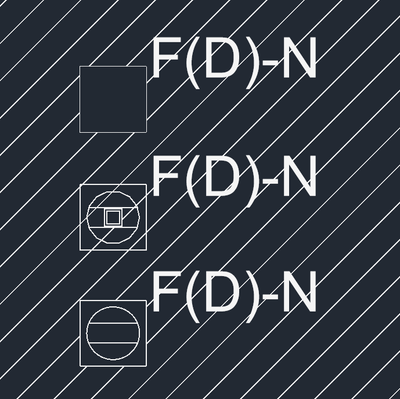

The rectangle shape of the extrusion is only the proper size at one particular scale. The masking region was hiding it at other scales. The extrusion should probably be hidden in plan view since you have the generic annotation.
Here are three versions of your family on a floor that has a pattern. The original family masks the floor pattern but also the lines in the annotation family. The second is with the masking region deleted, which doesn't mask the floor pattern or the 3D extrusion. The third family uses 4 separate masking regions to recreate the symbol.
