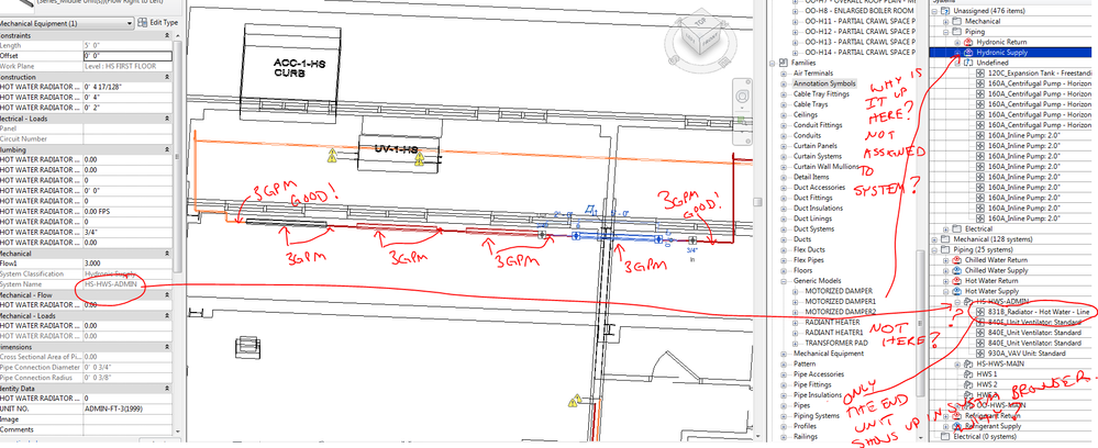

Hi all,
So I was able to get the system to populate in such a way that it is somewhat usable. However the system browser doesnt update properly. Even though the fin tubes are showing that their system name says they belong to the system, they dont show up under that system in the actual system browser. Why is that? see below. I did this by setting the connectors on the end fin tube to Preset, IN/OUT, Hydronic Supply/Return and the connectors on the chain link tubes to Calculated, IN/OUT, Global with connectors linked. Anyone know how I can make them show up under the right system with out double counting the GPM in the system browser? Thanks!Capture.PNG

RobDraw
Sorry, I haven't been able to play with system classification and names much, but have you tried changing the connectors to something other than global?
(I'm also away from Revit, so I can't even play with my theory. I'm way overdue for getting it on my home machine.)

fabiosato
Hello Revithero,
In this setting I believe using hydronic supply/return connector type is better.
When I use global type, I use the same type on both ends, so both will belong to the same system.

Scott_D_
Why not use a single circular extrusion between two reference planes to represent a pipe with connectors on either end and then use an Array of the fin tubes so that its just one preset IN Hydraulic Flow connector, one preset OUT Hydraulic Return connector and the rest is just pretty graphics.
Each family Type will be '1x 1200mm fin tube' or '2x 1600mm fin tube' etc with instance parameters for the flow value and loss.
