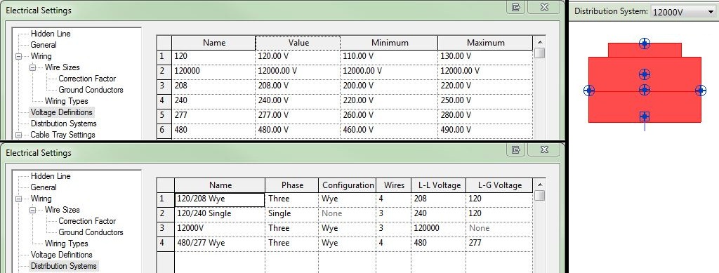

1. Have your gone to Manage tab » MEP Settings » Electrical Settings? You have to define not only a Distribution System, but you will likely have to create a Voltage Definition first. If you have done this, could you post and image or describe what you have for each?

1. Under Electrical Settings, go to Voltage Definitions. You have to tell Revit that the voltage exists before you can create a Distribution System with it.

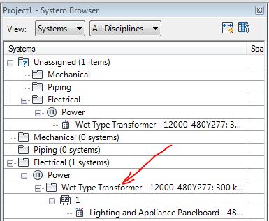

2. Even with my transformer assigned to a distribution system my system browser still lists it under Electrical/ Power/ <unnamed>/ SVC Trans. This also appears as unnamed when I select the the transformer, click on the Electrical circuits ribbon and look at the System Selector tool. No other names are listed in the pulldown list. (see attached screen shot)

1. Yes:
2. I connected a random 480V panel to the Transformer and my browser looks like:

1. Got it, thanks. I was overlooking the voltage definition so I couldnt assign it in the Distribution Systems. Once I added that, it was easy to create the 12000v distribuiton system & assign my correct wet type transformer to it.
2. I was playing around with my service transformer some more & deleted out the Power system I had connected it to (which would have been the primary feed from the utility co & is out of our scope any ways). That's what was <unnamed>, now my distribution power starts at the transformer like you have.
