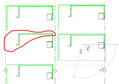

Message 7 of 11
iainsavage
I watched your videos again.
It seems to be pipes at a higher level which are not visible in parts of the view?
Is there a Plan Region on the view?
Message 8 of 11

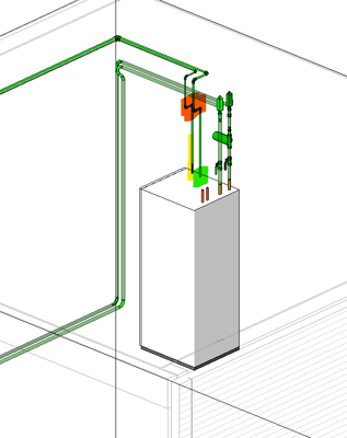

sander.van.pelt
I don't have a plan region in my view.
And to give an even clearer picture of what my installation looks like, I have included a small 3D view here of the device and the routing of the pipes connecting to it.
In your image, you do indeed indicate the pipes that are at a higher level than the other pipes.
However, that is not the case everywhere above the device. A bend needs to be made there to get underneath the other pipes (shaded orange). Looking at the installation visible in the bottom left of your image, you can see only 1 of these 2 "bent" pipes connected to the device (shaded green).
The other (yellow) is not visible.
It is actually one pipe trace that has disappeared here, entirely. But...

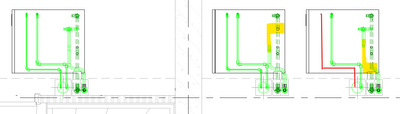

If I copy this setup visible in the other image multiple times (same project, same view, same workset), some parts of the trace are not visible in the copies.
This is despite the fact that the pipes are completely connected to each other.
So I really don't understand why I can see that family one time but not the next, and why I have to copy multiple times to eventually make everything visible. This is despite the fact that they are actually present.
But those invisible pipes are not visible in the sheets either. That is quite important, though, if they are going to use the sheets on the construction site.
