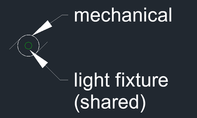

There is one possibility you could try out and see if it works for you.
  • Create a dummy light fixture family with very small 3D object that is not visible in floor plan. And a small 2D annotation that can be done with symbolic lines.
  • Check the "Shared" option.
  • Embed family with your mechanical equipment family.
  • Insert Mechanical family into project.
Now when you go edit system you can select the lighting portion of the mechanical family.
Might take a few trial and error to get it exactly how you want but that would be the only way I know to make that work.
See screen shot for an example.

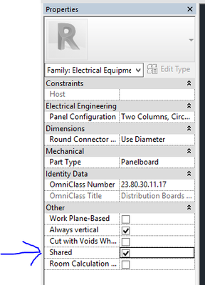

bmaldonado6X2W5
Withing the family editor, in your properties menus, make sure shared is turned on as it shows below.shared option.PNG
