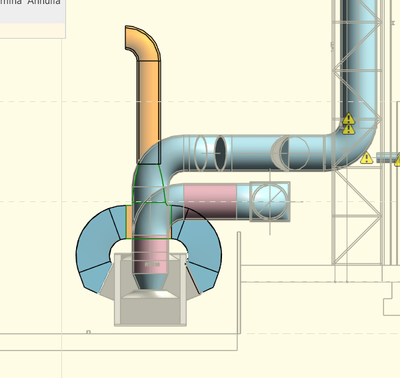

Not Yet, I made a try but I went back on my own to finish the Revit Duct. As I can see none of ducts seems come from Parts but system classification differences are not easy to change..

These connectors below are set to Supply Air but you have them connected to Return Air ducts.
So as I said earlier this causes problems in the system.
Change the connectors in the family to Return Air with a direction of In.
When the family is reloaded the ducts and fittings will change to Return Air classification.
These connectors below should be set to Supply Air and with direction of Out.

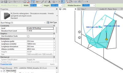

These fittings below are not properly connected hence the confusion in system type:
These fittings are 1000x400mm but the connector on the heatpump is 1000x440mm
The fittings are not aligned to the centreline of the connection on the heatpump:
Get them aligned and then drag each fitting to the connector of the adjacent one until they are all connected and the warning triangles disapear:

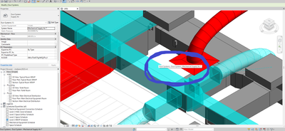

Use tab-select to select the exhaust system in this fitting, then delete the system:
Then do the same for these two fittings:
They will then adopt the supply air system which they are connected to.

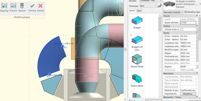

mzmaso90_0-1688103624424.pngI don't understand why if changed the reverse orientation of flux of connectors, between two same family one gives not problems the other says that  the segment has been drawn on the wrong side. What would that mean?

I'm not sure what you have done here - the only thing that I can think of is that you have misunderstood what I meant by changing the connector direction to "In".
Did you reverse the direction of the connector so that the Z axis was pointing into the family? If so that is not what I meant:
What I meant was to change the connector setting from "Bidirectional" to "In" at the proprties pallette. Z axis should still point out of the family but the flow direction should be In.:
