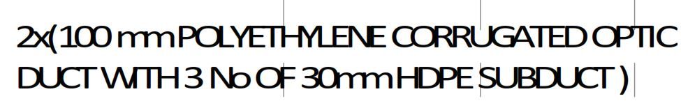

i have a problem when i  print pdf from revit 2020 , i found the calibri  font changed to another font and the spacing is wrong can any one help me ?
here is a screenshot

I would imagine it is something to do with your pdf printer settings and embedding or substituting fonts.
Personally though I would stick with Arial because you are creating a lot of work for yourself for ever if your going to change fonts in every family, tag, bubble etc etc. Like it or not just about all available Revit content uses Arial.
