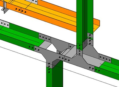

The main cable tray backbone will be installed in the building's four-story shaft. From it, a dedicated floor cable tray will branch out at each level.
However, the software is unable to generate a vertical "T" connection. Can anyone help me?

Is there a suitable tee family in your routing preferences?
What would the connection look like in real life = would the horizontal runs not just start with a downward looking bend so that cables can sweep onto them from the vertical run?

You would need to find or create a suitable Revit family, maybe from a manufacturer's BIM content?

I got a reasonable approximation just by creating the horizontal, and then one elbow by making a vertical.  Then I drug the riser past the bend, and in a section view, I mirrored the bend.

I created a horizontal run, and then changed the elevation of the run, and created another horizontal run so you have this:
Just delete the bottom elbow and section if you don't need it.
Then I drug the vertical riser past the elbow:
You can do this in a 3D view, or in a section view.
Then go back to the plan view and create a section.  And mirror the elbow.
Its more of a workaround, but you could trim the vert & horiz. sections and "group" them so they stay together.
You might even be able to lock them to the try so they move with the tray, but they are more workarounds that a working family.

You can create a family for that purpose, but it will not be created automatically.
I suggest you use the multiport part type for this kind of fitting.
