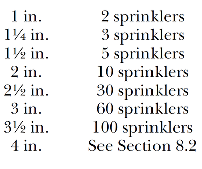

is that any way for making the fire pipes sizing automatically in Revit...

but elite and hap are not for sizing I need that for sprinkler pipes because it flows a certain rule in sizing but I do not know how Revit can understand this rule of sizing...

the pipe size is scheduled in NFPA code for firefighting as in the below image
if you could automate the sizing of pipes according to this rule.
