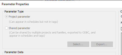

Would I have to make a new parameter? The building parameter is assigned as a project parameter, but it seems I cannot change it to aa shared parameter.
dmiller_SCE
Yes, you would have to create a new parameter and make it a shared parameter.  With it as a shared parameter, you can add it both as a project parameter and a parameter into the title block.
