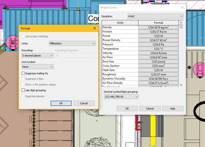

1. Rounding problem:
 Manage tab> Project units> Discipline> HVAC> Duct Size> Rounding (To 0 decimal places or To the nearest 10 or ...)
