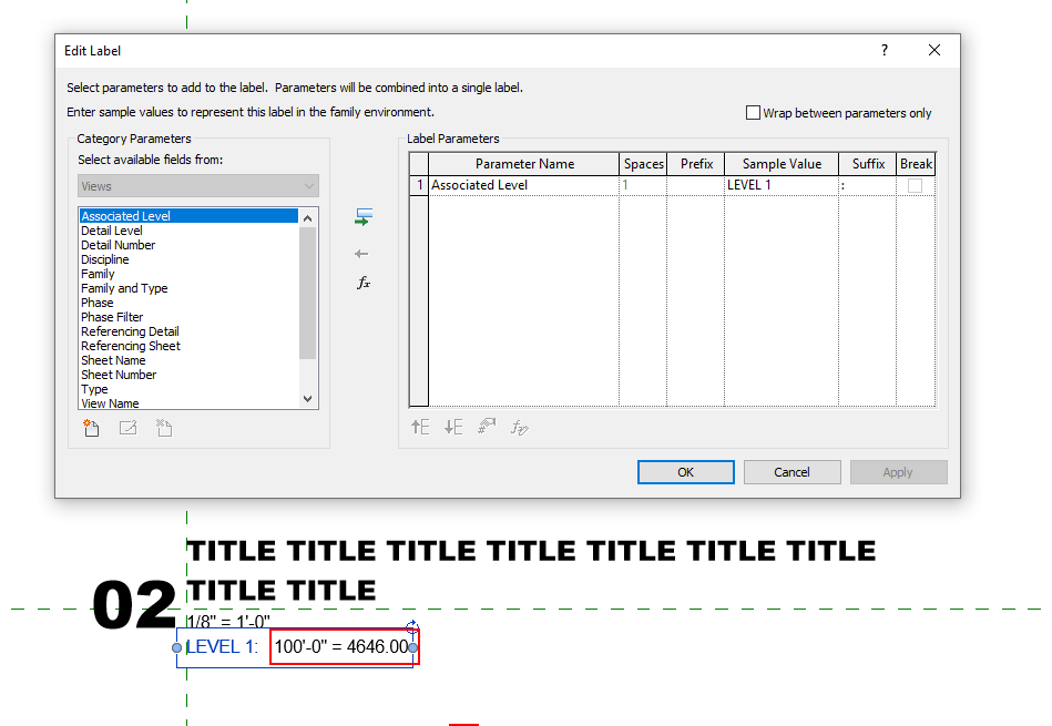

I would like to be able to include the elevation of an associated view on my view titles.  Currently i can label the Associated Level Name but I can't find anyway to include the Associated Level Elevation.  Please include Associated Level Elevation as a parameter to be used in labels of view titles2019-09-11 15_34_30-Autodesk Revit 2019.2 - [HKS View Title - CD.rfa - Sheet_  - ].png

Hello
Till it gets implemented, for the workaround, You may rename the Levels with " Level Name + Level Elevation "
Example: Ground 77.55m
Issues arising due to this change and some solution.
1. View names will change, but theres a " Title on Sheet " which can help
2. Levels in Elevation and Section will get affected. You may create a new Level type and customise
what to show there. Probably two types of levels.. one with its own original name " Ground 77.55m " and second with only elevation.
Cheers.
