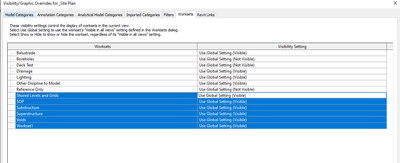

Another interface improvement would be under Worksets, when you select multiple worksets and set them to “Use Global Settings” for the workset visibility, for it to actually use Global setting not take on the setting for the first one.
As you can see with the images below, I’ve set all those to Use Global Settings but since the selection is “Use Global Settings (Visible)” it takes on Visible when two are not actually Globally Visible.
