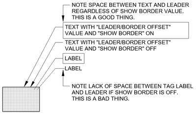

In a Tag Label, if "Show Border" is OFF, the "Leader/Border Offset" value is ignored for Leaders. Instead, the "Show Border" value should not affect the "Leader/Border Offset" so that Leaders are offset by that value. This is the way it works in Text with the same parameter names.

Someone is likely to come across this idea when searching for a solution to this issue. There is no solution yet (please vote). The only workaround that works in most conditions is to turn "Show Border" ON and make the border Color value White. Again, this is a workaround, not a solution, and it looks bad if the label overlaps other objects. Also, depending on your tag's line weight, it might display a dot at the tail of the leader where it crosses the white border.
