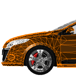

When importing in REVIT 3D objects created in 3DS MAX or Sketchup for instance, we end up with meshed objects as we can see on the picture below:
Currently the only solutions available to hide this mesh or limit it’s visibilities are:
  • Use trial and error method in order to find the layer color that match best the surroundings
http://knowledge.autodesk.com/article/Removing-lines-of-imported-3D-geometry
  • Or edit the 3D objects in 3DS Max in order to make the mesh invisible before importing the object in REVIT.
http://www.formfollowsperformance.com/2013/04/mesh-geometry-into-revit-without-triangulated-edges-vi...
The idea would be to add a feature / option in REVIT that would make this process easier.
For instance adding an option in the Visibility/Graphics dialog box to toggle between “Hide / Show mesh" would be perfect.
