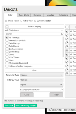

We use DiRoots One to do this as well.  The module is called one filter.  You can select catergories, objects etc based off a certain query.
@twellins : I used DiRoots One as well. But there are too many mouse clicks in the process. I was thinking something much faster, like Workset Isolate and fade the rest of the model, similar to LayerIsolate command in Autocad.
