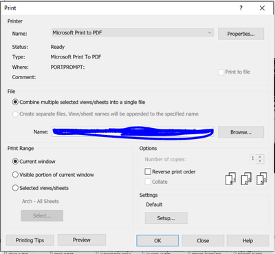

In the print dialog, the default is to create individual files. This is rarely a good idea, especially if you have  set of 150+ pages.
Furthermore, there is no way to cancel the whole operation if you accidentally let it print your 150 pages individually. You have to sit there and say cancel 150+ time or forcefully close and restart Revit, assuming you had remembered to save before.
I would suggest you use "Combine Separate Views/Sheets into a single file" as the default.
Also, give us an option to cancel the whole printing operation when we make the error to print the pages individually. This is a large source of frustration in the office and it could be solved easily.

I appreciate that there's now a warning popup now which says are you sure you want to create separate files because it has saved me from accidentally creating  40 pdf's.  However, a warning popup being necessary for a default setting on a routine task seems to be an indication that the wrong default is being used.
Having it stay with last used or combined seems to be a better solution; as well as not changing when other properties of the print job are altered - that is confusing / annoying.

It looks like this was already implemented in this exact duplicate Revit Idea.

@kimberly_fuhrman-jones it obviously has not been implemented, Revit 2024.2, still the option by default....ddd.PNG

Please advise on the next step since it was marked as implemented but not tested.
@tlagardeAJBTA ,
This is from a clean install of Revit 2024.2. The default is to combine into a single file. I'm not sure why yours is different.
