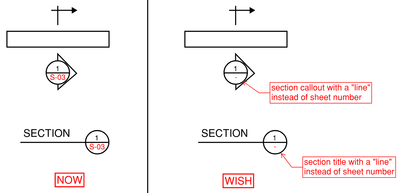

I would like to have the option to replace the sheet number of a callout and title by a dash ( - ) when the section (or a detail or whatever) is on the same page as the view where it come from.
Exemple :
This makes it quicker to see wich sections/details/other views are on the same page.
Make it optional so people who don't want it don't have to deal with it.
And personnalisable (like the new feature to specify "multiple values indication") so people who would like something else could.
And of course, if there is another callout of the same detail on another sheet, this one should refer to the good sheet and not have a dash.
Thanks!

Hi!
You could get there having diferent tipes of head sections instead.
Evalucia
Hi, yes that's already what I do.
