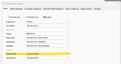

ctm_mka
you mean this option which does not appear to do what we want i to....
