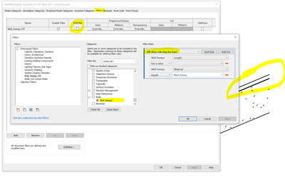

I found that you can specify a Material to Wall Sweeps that are built into the wall. Then you can use fitdmore's view filter but use the Material property to hide them.

curtisridenour
@PatrickGSR94 it seems to work fine on the wall sweeps i added to this wall type.

curtisridenour
What version of Revit are you using? I am in R2025. See an image below of the view filter settings. It is applied to Wall Sweeps.
PatrickGSR94
2025.3.
It doesn't work.  With the OR function like you have it, it hides ALL sweeps in the wall type.  With just the Material setting, it doesn't work at all.  All sweeps still show up.  I want to be able to control sweeps separately (such as hiding a baseboard sweep, but showing a brick wainscot sweep), and trying to filter sweeps in a wall type, using Material, does not work.

I should have looked back further in the responses to this idea. @PatrickGSR94 is correct for his needs. It hides all sweeps within a wall and will not delineate between different ones based on material or profile. It is like Revit is playing a cruel joke on us. Giving you the ability to hide all (it knowing it is a wall sweep) but not different kinds based on parameters (which it most definitely has). What a huge bummer.

yep, the Material rule isn't even needed if you want to hide ALL the sweeps.  Just use the Length Has a Value rule.  That seems to be the ONLY thing that will work on sweeps, as it pertains to filtering.
