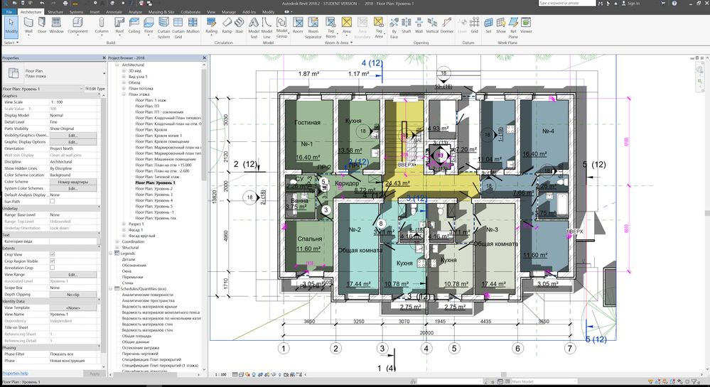

A zoning function for Rooms like it is in autocad architecture. This will be useful when you have more than one apartment on a floor. Rooms belonging to a particular apartment can be grouped together and the total floor area can be extracted und used for Tags.

It is necessary to create the opportunity to combine the rooms into groups with the possibility to receive data from specifications and marks about all the elements of the group. So you can combine several rooms in an apartment and get the total area of ​​incoming premises in the mark, as well as create a specification of apartments and the composition of premises. This is applicable for offices, hospitals and other buildings where rooms are classified and grouped. Logic work with the current premises with the addition of their own parameters is not enough, there is no possibility of obtaining a single mark.
