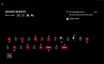

joneilBQXK7
Might be a dead thread but I had the same idea. I use a G602 mouse which has programmable buttons. Through the logitech software i made a marco that rotates things 90 with a single click. There's a little delay after the click and before it types 90 so you can move your mouse for CW or CCW.
dbobber
Nice! thank you.  for showing that Joneil!
