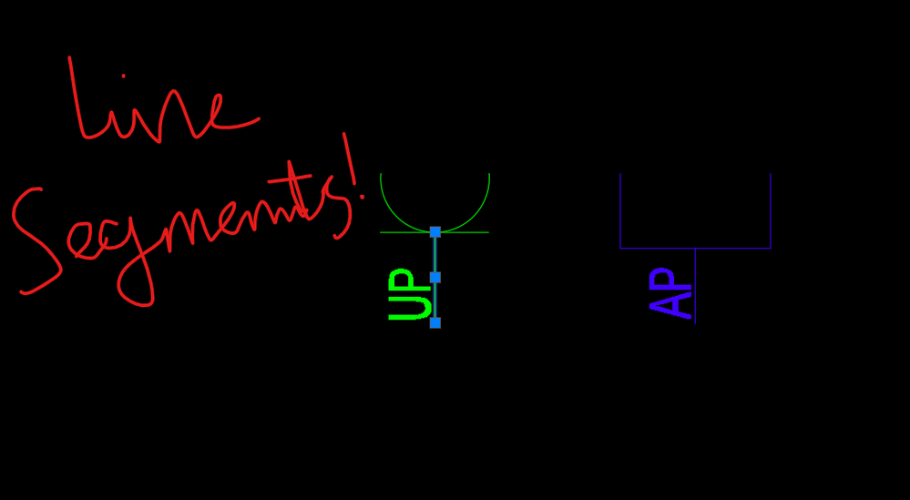

When exporting a 2D view to DWG format in Revit, the families are broken down into individual line segments in AutoCAD rather than exported as blocks. I’m already aware of the EDER-Tool plugin, which can enhance the export process, but I’m interested in exploring other methods such as Dynamo, Revit API, or an alternative plugin.
Any suggestions would be appreciated.

but you have build the familiy wrong
if the family is build correct it will export as a block
Revit familiy
 Autocad block
The problem is the 2D symbol of the installation plan
This must be a detail element of the family
and build from model lines
then load in the main family
Then it will be exported as an autocad block

 But Revit builds a seperate block for every instance
so it is not possible toi count them cause they ghave diffrent block names
