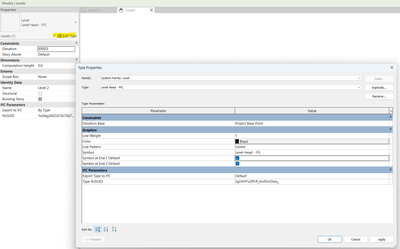

Is this the item you are trying to bring back?
Selecting the Level should show the blue Box but if not try changing the Level Type to another Style and also check the Edit Type Settings to see if the Symbols are turned of in the Family itself

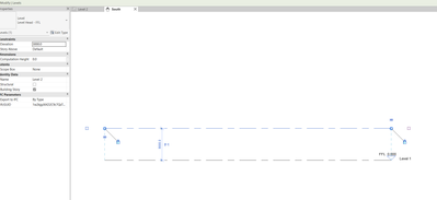

when you have a level, any
______________________________Level 1
                                                                   3000 m
like this for example, and to modify the name of level (for example), just double click in the name and edit the name
after you edit, a windows pop up telling: if you dont want this message again just click in the box
(i did it, I clicked in the box)
and now, afyer that, whenever Im in REVIT, never more show the windows,
Including restarting the revit, closing and opening again, new project, etc etc, never more the wondows pop up
I would like to have it again.
