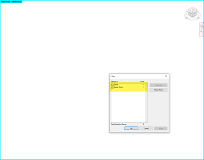

Hi Everyone,
I don’t know what I did to cause the Zoom All to be so far out when I click on the view cube's home icon in the 3D view! (I checked that there are no scattered elements on the screen causing the zoom to be extended)... please check my 3d  settings in the image below and help me to solve this issue

Got CAD?  Hide Imported Categories via the View's VGOs and try Zoom to Fit again. Better?

I checked that before, as you can see below. The issue lies elsewhere!

Hard to diagnose without examining the file.  Post it here.
Can you Reset Shared Coordinates?  If so, try that.

I don't know right off why this worked, but deleting all the stairs in the Project fixed the issue.

Yah, you got a one rogue stair out there in space somewhere.

Thank you for solving this issue. However, I don't understand the relation between this issue and the stair position in the space!!?

Consider using scope boxes to avoid this kind of situations
