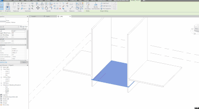

Z shape floor
Hello friends,
How to draw "Z" shape slab which shown on pic in revit
Thanks.
3 REPLIES 3
RDAOU
in reply to: yoosafshajeeb
@yoosafshajeeb
You place 2 concrete Slabs first
Then you connect with either of the following
  1. A concrete wall (same material and join Geometry)
  2. A Slab Edge
  3. A Concrete Rectangular Beam
syman2000
Normally I would simply draw floor slab. Set it to drop depth + floor thickness.
Once you have the floor drawn, then use join geometry
Any approaches above are feasible.  It depends on your design to choose which one:
- if the thickness of the vertical is constant and the height varies among the drops in your project, then using walls is easier and you only need one wall type
- if the thickness varies, height is constant, then using floors is easier with one floor type
- if both thickness and height are constant, then using a profile based approach (slab edges, beams) for consistency
