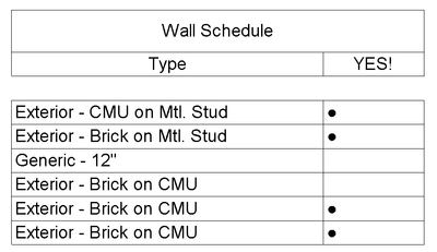

You know, instead of having checkboxes in the Schedule, what about a dot or another character map symbol? That way you wouldn't need to mess with those formula-driven "Yes" Values. I mean, the bottom line is that this is just about how the Schedule looks on the Sheet; right?  Format it differently then.

Great suggestion of the Dot. But I can't get it to show up. What exactly do I need to type and do I need to place it in " " marks?
Message 12 of 13
RDAOU
@bdewilde It’s a text symbol/character so yes you need to place it between quotation marks “”
Message 13 of 13
Mike.FORM
@bdewilde you need to create a calculated parameter for all the fields you want to show as a dot, then you hide (not remove) the original yes/no parameter in the schedule so that it doesn't show up. The formula would be     if(Parameter Name, "●",  "")
