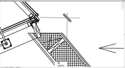

I'd like to wrap the right side layers of this slanted wall over the top of the wall from right to left. Is this possible?  Playing with wrapping doesn't seem to cut it.

Wrapping is not supported for walls with a tapered cross section.
