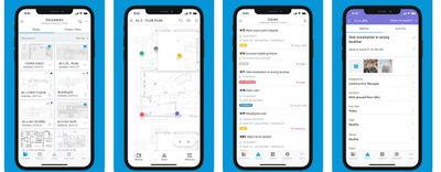

RDAOU
@HVAC-Novice
Any app you use require a little bit of reading and a little bit of practice...
BIM 360 has both Android and IOS apps you can find their download link in the below AKN Articles... you weren't using the browser were you?!!!
BIM 360 ANDROID APP
BIM 360 iOS APP
and this is how the UI looks like
