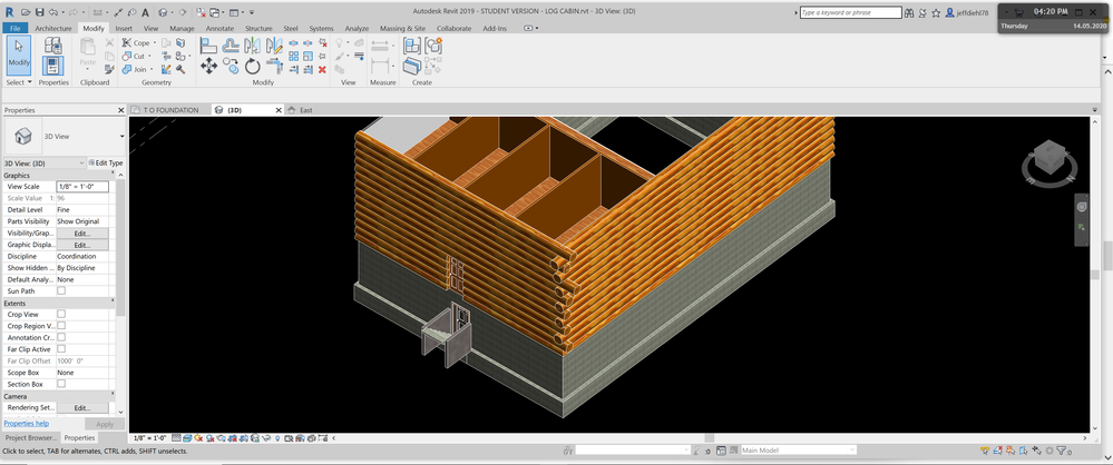

I am trying to make a full wood log wall. I've tried creating a log profile then using sweeps. Just kept getting error messages. Anybody know of any downloads or tutorials to make this type of wall.

Betcha five bucks that you got an overlapping line in the Profile.
btw, I would use Curtain Walls myself.

I used to work with a Wall with Reveals or Sweeps..that's something from around 4 years ago...

After trying for a few hours this is what i came up with. Still got some tweaks to do and if anybody has some input i would appreciate it.Screenshot (1).png

Yes i get that message. I just ignored them and kept going. This what i came up with.Screenshot (1).png

Let's check it out. Post the RVT.
