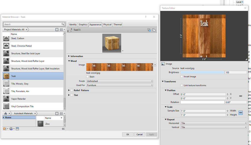

I am struggling with this problem for long. Attached is one rendering at 'Medium' quality of Teak Wood. My problem is that ( i have tried all settings i knew ) it does not show the wood grains at all in rendered pic. It does not show the wood grains as is shown in 2nd attached pic.
And, the problem is not with just Teak Wood, it is with all Wood materials available in Revit library.
What is wrong ? Please tell me.

Did you setup the material, duplicate the Appearance asset, and add the image you want?  By the way, the image you posted is not a good one to use in a material, it will tile badly as shown in my test below.  I suggest you use one of the OOTB Teak wood appearance assets instead.  There is a reason they don't show the grain too much and top strong is to avoid the ill tiling effect.

The attached screen cast will put my problem clearly. I created one Teak wood material from library. Rendering does not show the grains as shown in the Material Image as displayed.

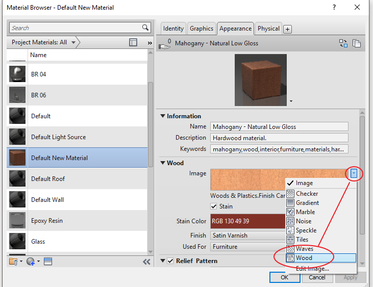

Enabling the custom option has a feature to play with the 'grain thickness' - see image below. In certain interior views these settings/additional image for grain enhances the material appearance (looks like wood) rather than just plain brown color.
Again this depends on your model size and render view settings.
From your screen-cast, it looks like you have to select the custom option from the relief pattern settings as shown below.You can adjust attributes like noise etc.
Please mark this response as "Accept as Solution" to help other seeking similar solutions and if it answers your question.

1. Relief pattern based on Wood Grain only works if you choose procedural Wood for texture, not if you use an Image for texture.
2. If you use an image for texture, you need to use Custom for Relief pattern because the texture Image does not have any "grain", only colors.  Under Custom, you can pick any image to create the relief pattern.  Normally, a black and white or gray scale image provide better result than colored images.
3. You can pick the same image used for texture to be the relief pattern image.  But as I said above, a monotone image provides better result.
