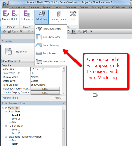

Just following up on this post. Assuming you downloaded from here:
Then the extension should appear under Extensions and Modeling:

To be sure I follow here, you click on Extensions and you see Modeling but under that you do not see Frame Generator, Grid Generator, Rafter Framing, Rood Trusses or Wood Framing Walls?
If this is the case I would uninstall Revit Extensions for Autodesk Revit 2017 and try reinstalling it. If that fails I would temporarily disable all add-ins for Revit. Here's a link with instructions, however in your case there may be a conflict with another add-in. I would move all add-in but leave the folder and only install Revit Extensions for Autodesk Revit 2017 to see if everything under Modelling as I mentioned above appears.
If it does work then start adding back in the other add-ins (a few at a time) to see if you can spot the offending one. Keep in mind that you will have to restart Revit after you add in the extensions, then test, verify that all is well, add in a few more, restart again and continue testing.
I hope this helps and let me know your results.
