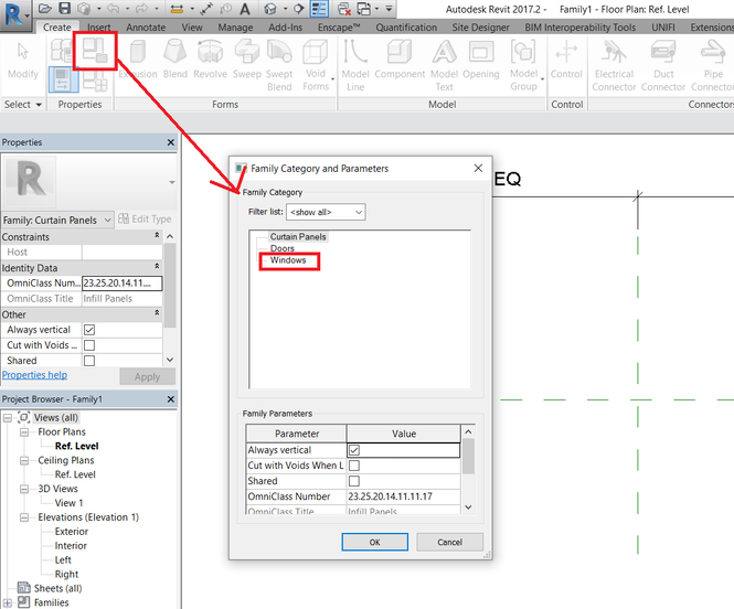

There should be capabilities to turn curtain wall into a window without having to redraw it, and vice versa.

Yup...edit the family. Go to the category and switch it from curtain panel to window.
