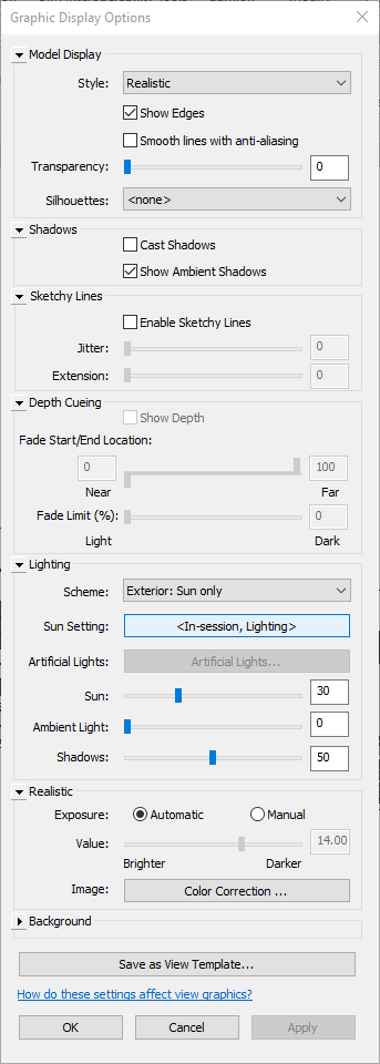

The Appearance Asset has no Transparency?  What Asset are you using?  Post a screenshot the Appearance Asset settings.
Also, what do your Graphic Display settings look like?

I'm using a glass-based asset. Because in 3D views with a Realistic look I want the glass transparent.
