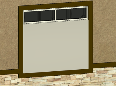

How do I show the window opaque in a realistic 3D view. I do not want to see through it like the picture shows.
(RVT 2024)

als Antwort auf: johnFKF43
Change the glass material to an opaque glass

imankassab2015
Edit the glass material to be opaque
Try to know the material name then
In manage tab - material window - select the material name - if you change the whole type globally use this method and in the appearance tab for material you will add color to make it opaque with certain color from you choice
Accept my answer if helped you
Make the Opening in the Family NOT Transparent.

I lose the window when I do that. I want the glass itself to not be transparent in 3D

You Edited the Family, selected the Opening Cut, unchecked Transparent in 3D on the Options Bar, reloaded the Family into the Project and you lost the Windows? That doesn't compute.

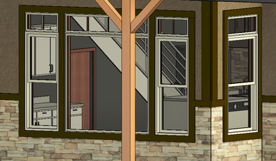

johnFKF43
als Antwort auf: barthbradley
I tried it again and some work and some don't. This is weird! The window is still there, but the window opening is covering it.
No clue what's going on at your end. I'd have to see your file. But it looks like you found a solution, so I'm guessing you're good to go.
At my end, FWIW:
