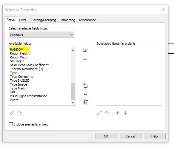

Type parameters will show up when you create the schedule - in my screenshot, the parameter RANDOM is a Shared Parameter. A Family Parameter will not come through in the Schedule, you will only be able to access it through the placed instance properties.
