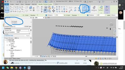

hello.
I made a mass surface and set a roof tile pattern, but the roof tile turns up side down. Any reason?
is the line sequence (3 points) affect that?
Thank

Adaptive components have Flip control.  Have you tried it?

I found that the reference points to place the surface indeed up side down and need to be flipped,

sorry I wrong press the "accept solution", it is not solved yet. though I set tile pattern 4 AP to be global XYZ then works, but the tile pattern cannot twisted along with the surface.
Please advie how to set AP in pattern based "flipped"?
That is what Global XYZ means.  Instance Z + Host XY, or Global Z + Host XY.
