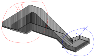

why Revit rails are not maintaining the height of 3' in my model ?

Revit Rails are behaving strange I placed them using "place on stair/ramp" option. at once side rails are in the height of 3' as normal but at the red marked area the top rail is not in the height of 3'. what could be the reason.

Uncheck "Use Landing Height Adjustment" under Railing Properties.

Hi, I have found the solution after I tried figuring out the issues. what i did is that I am selected the rail and selected the edit its sketch and adjusted the sketch with further from stair flight to the landing with enabling the preview I was able to see the changes were happening in same to i fixed it while adjusting the sketch of the rail path.
Thanks for your Support and time.
