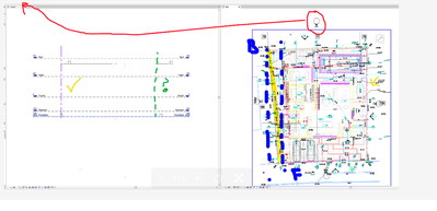

hi
i have to see in my elevation 2 reference lines, but i can see only one.
i understand that it has to do with the reference line angle vs elevation angle but how to tackle it when have this kind of situation.
please help

Why do you want to see Ref. Planes that are askew to the view?

Model a mass form and you can see where it is cut in a section.

Hi!
You can do 2 ref planes and name them like start front and end back? so you´ll have the 2 references
