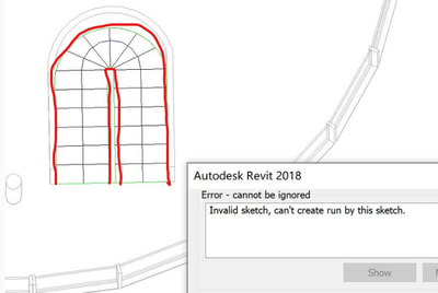

I use architecture-stairs-sketch to draw the stairs, but the error shows:invaid , Does somebody know the reason, thanks so much!

check it here in the previous thread and see if helps. thanks

check your stair height and number of risers and risers height? or post your file here so we can check. thanks

or try to click expand and click show to see the errors and see what are the errors. thanks

Only red are boundary lines, the rest should be riser lines.

thank you so much, solved
