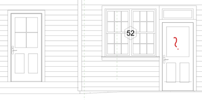

Added mullions to a door as an extrusion. Loaded it into my project and I can only see the extrusion on one side even though the extrusion passes the glass pane on both sides and has no visibility overrides.

Hard to tell for sure from your image, but my guess is the muntins are only on one side of the glass and the glass isn't transparent.

It is not constrained properly in the family so that when the wall thickness is different, the muntin shifted.  To fix it, set the work plane of the muntin extrusion to a face of the glass, or to a ref plane centered the glass thickness.
