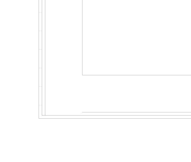

In the attached image, I used trim to join walls but as you can see, lines are missing at the corner.

Use the Wall Join tool to change the way it is Joined at the corner.

use the wall join tool

Sorry, I need to revise the question a bit.   The image I had attached is of an overlay looking up.
In the first floor plan it looks normal, but it is different in the overlay. Why would this be?

Actually, I don't think Automatic Join is turned on.  Allow Join.

What's the View's underlay settings?

Nevermind,   yes, wall join fixed this, thank you.    Why does that happen?
