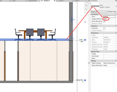

As per the attached, my walls go through the floor, how do I begin my walls from the floor base?

looks like they need a base offset.
...you know, typically the top of floor is where the Level is.

Is the top of the finish floor higher than the level?  You can attach the wall base to the floor or join geometry the walls to the floor.

I think the real issue is with the doors.  Looks like thresholds are buried in the floor.  I'd either lower the floor or create a finish floor level for walls, doors , etc.

set your wall from the level > base offset = 0,0. thanks

Base offset is zero

I lowered the floor and still seem to have the same issue. I am so confused, it's like you guys are speaking in a different language haha. Would you mind creating a screen cast to demonstrate please?

I understand your confusion and I believe the best remedy is to lower the top of your floor to the level.  Maybe you put in an offset for the floor by accident. Whatever, the top of the floor should be flush with the level.  This is the solution. Believe me.

@Anonymous: check the Floor's "Height Offset From Level".  Does it read 0'-0"?

looks like definitely you have another level around. Maybe from a linked file. And the floor is drawn on that one. My two cents.

in the image example I have a basic wall that extends past level 2 up to level 3
I included a Top offset and top extension (-3 5/8") to meet the underside of level 3 slab
the base offset = 0 which sits on top of Level 1 slab.
the (2) blue grips at the top and bottom are for splitting the offset and extensions of the wall components.
if you have 2 floors in close proximity and the wall projects below to the other floor, you can change the Base constraint to the correct floor, or set a base offset the distance between the 2 floors.
if i wanted the Wall to be @ Grade I would set my base constraint to that level or assign a base offset to (-6") from Level 1

Change 145 to 0.
