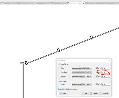

I'm designing a skyscraper for my architecture studio class, and on some floors, my curtain walls show up like this (see picture). On some floors, they are just fine like they should be. Please help!curtain wall.JPG

Is the Curtain Wall Mullions Category turned off in the View?

Lower or raise your View Range Cut Plane a tad.

My money is on View Cut Plane cutting through the Mullions in the Plan View.

Edit your View Range and change the Cut Plane height. Works like a charm.

couple of inches works for me.

Adjust your cut plane a bit so that it doesn't cut right at the horizontal mullion.

Thank you guys so much!
