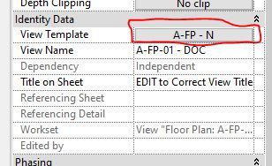

Under "Assign View Template" menu box, I select the applicable view template then click ok.  But Revit just reverts back to <None> and doesn't assign a view template. It does this for all views. Can anyone advise??

does it stay if you change it in property's of the view? that is where I usually set it....
If this is the button you are using, it only works for new views. Existing views won't change with this setting.
