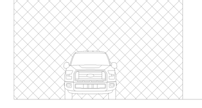

This is driving me crazy.  Once again, something that seems super straightforward in Revit turns out to be anything but.
I'm simply trying to create a 2d auto family that properly displays the auto in plan and on all 4 sides in elevation that knocks out any background behind it.  I'm importing the auto linework from CAD.
I've tried generic and site families without success.  I can get the linework to appear just fine, but neither a masking region or a filled region will consistently work to knock the background out.
I'm able to fake it in plan by creating a reference plane that is offset from the Ref Level and using that offset reference plane as the host for the linework and filled/masking region, but that's a lot of trouble and the trick doesn't seem to work in elevation.
What do you think I'm doing wrong?  See attached generic F150 family for reference.  Thanks!

You may want to convert the model lines to symbolic lines. The masking hide model lines. This is why it won't show.

Ok, that's helpful, but doesn't solve the problem.  The masking/filled region isn't knocking out the background when the family is loaded into a project.

I look at the family more carefully and it looks like the masking is tie to parameter called front visibility. I remove masking ties to visibility and tie that to the lines. See attached

I need to be able to swap between front and rear views of the autos and couldn't find another way to do it so that the rear view lines aren't visible when it's just supposed to be the front.  The idea was to control the visibility of the lines and the mask with an instance parameter to give the drafters the ability to swap between the two- is there another way to do this?

You can create nested family where you can swap between the family. This will help making your family less complex. See attached family so you can reverse engineer to what you wanted for other vehicle family.
