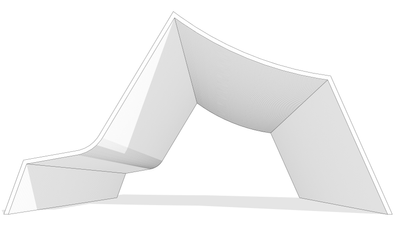

Hi, I am new in Revit. I am trying to model the finishing layers of the walls and ceilings of this house.
In a Youtube video I saw that it was possible to model tongue and groove using a curtain wall/sloped curtain wall for the ceilings. That worked for the inside of the house where the planks are right next to each other.
Nevertheless, for the gallery roof and the outside wall I need to get a small separation between the planks
In Youtube I followed a video where they made floor and wall In Place Components. The problem is this creates a lot of geometry. I already followed this process for the ceilings and I can't imagine how messy it will get if I try to cover all the walls.
I'm not planning to render the project, but I do want to make some 1:5 details and perspective cuts with all the geometry.
What will be the best way to achieve this?

I would not recommend modeling individual planks, but assigning a wood material to your floor or ceiling. A material can show a surface pattern matching the size of the planks, and a texture for realistic views or renderings.
If you want to actually model it for some reason, use a sloped glazing or a beam system.  Or, create parts from floor, wall, or ceiling; divide parts and assign a tongue-and-groove division profile.

I am looking to extract graphics from the model like this one:
https://www.instagram.com/p/CzQa9VmLPfP/?img_index=1
So it's not rendering but I need the lines to show on the model

I don't know what I'm supposed to see in those images, but if you want to model T&G Walls and Ceilings as you stated above, I would use Beam Systems. Might contribute a little more "I" to your "BIM" Model.  If you have a "wavvy" Walls and Ceilings, which I do see in those images, Structural Framing/Beams can follow "wavvy" edges via 3D Snapping. However, if that's the intent - "wavvy" Walls/Ceilings - I'd suggest doing the T&G as a Pattern-Based or Adaptive Component.  Know what I mean?

You can use model pattern to simulate the vertical T&G. Just use the Roof Extrusion. When you print, the model pattern will have print with lighter lineweight.
